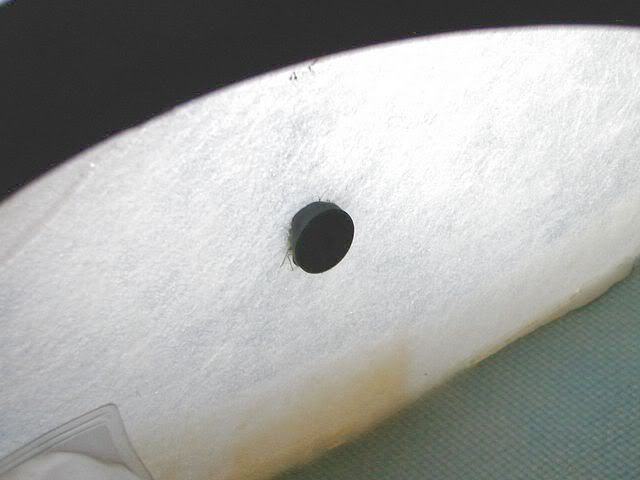

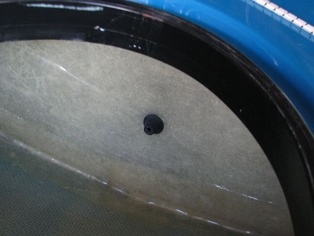

Similar
but with material on both sides of bigger diameter than the hole in the bulkhead (please excuse the backlighting on one of these, but you get the idea):
http://img.photobucket.com/albums/v718/mhackett/boat/IMG_4459s.jpg
http://img.photobucket.com/albums/v718/mhackett/boat/IMG_4461s.jpg
In any case, surely it is an off-the-shelf part, yes. The interesting (yeah, right…) thing is the decision to implement it.
Mike
