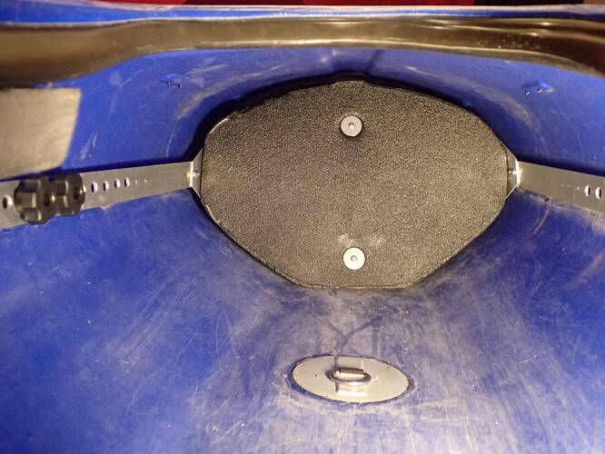

I replaced the Prijon foot pegs in my Yukon Expedition with a bulkhead style foot brace which I made. I used the foam from the bulkhead which was originally glued into the bow as the padding on the foot brace. The foot brace is similar to the foot braces in my Prijon Tornado and Rockit. An advantage of this foot brace is that instead of having space between the foot pegs and the back of the foam bulkhead which is difficult to use, I now have space in front of the foot brace which is easy to pack from the front hatch.
This picture shows the extra space for gear which you can pack from the front hatch.
I made UHMW plastic wedges to tilt the top of the bulkhead forward by 15 degrees. The foot brace is upside down in this picture.
