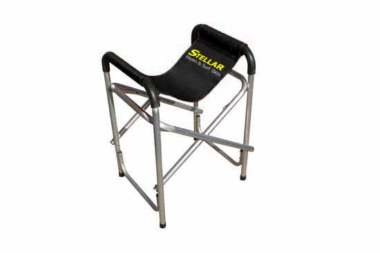

Or there’s my lazy way and just plop any kayak on edge into a pair of Stellar Sling Stands which also fold up for compact storage.

I was wanting it at nearly floor level. The more upright the kayak is, the move likely it will want to tip so j rack style of slightly tilted in one direction might be the way to make it work.
