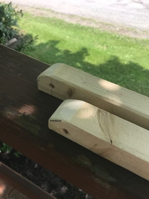

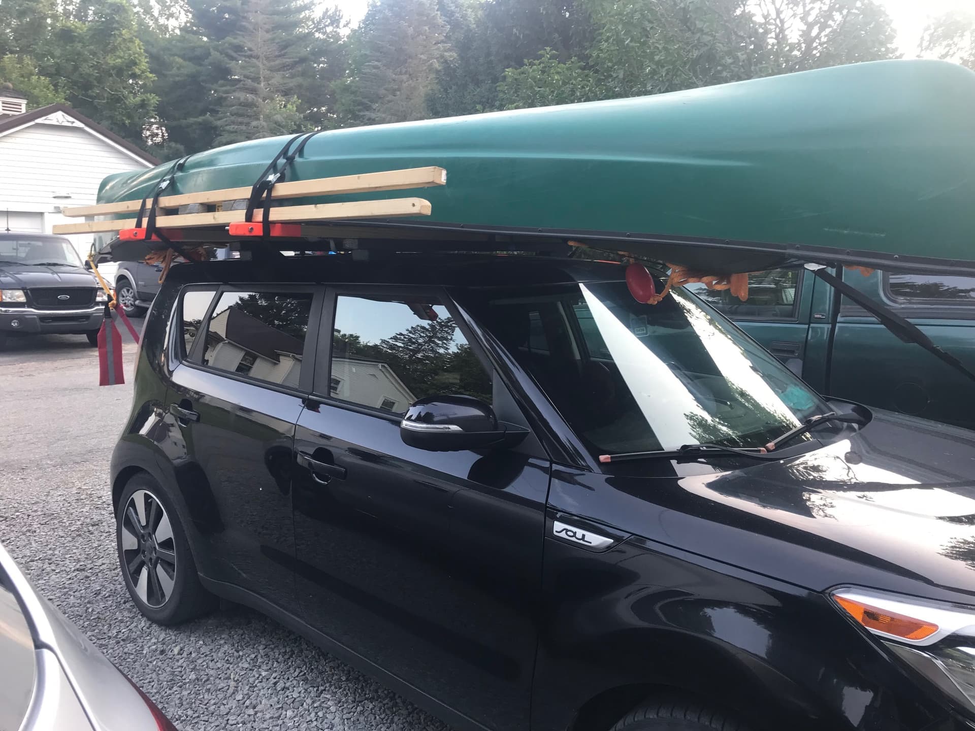

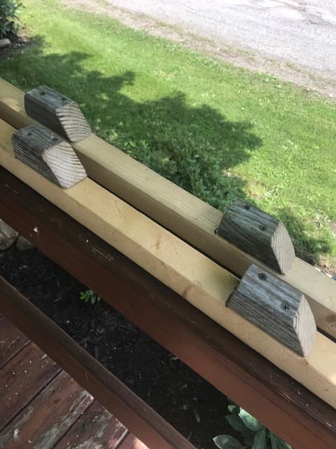

This was posted by bud16415 as a cheap way to get a boat up on the rack. With a kayak if it is too heavy for you to slide it up you might want to use removable 12" stakes you alternately pull out and reposition under the kayak as you move it up one side at a time. Also, a rope tied between the two poles at the bottom to keep them from wanting to spread apart might be needed.
"With a canoe it is a bit different as there is a gunwale that makes a square corner to hook over the blocks attached over the poles. My poles and blocks I made from 2x2 wood.
The walking method I tip the canoe over upside down onto the poles sitting at an angle. I then walk to one end and lift it over the first block. Then the other end. It is easier for me though to just shove it up a step at a time saves walking back and forth. The blocks I put a ramp on the lower side will attach a photo.
When we use it to load her 10’ rec-kayak we can flip the poles over to the smooth side and she can easily just slide it up the ramps right side up. Keeps it away from banging the car and makes it stable and also removes some of the weight because it is a ramp of roughly 45 degrees."
As to a sea kayak I really don’t know if just the ramp would work, as we have never tried that.

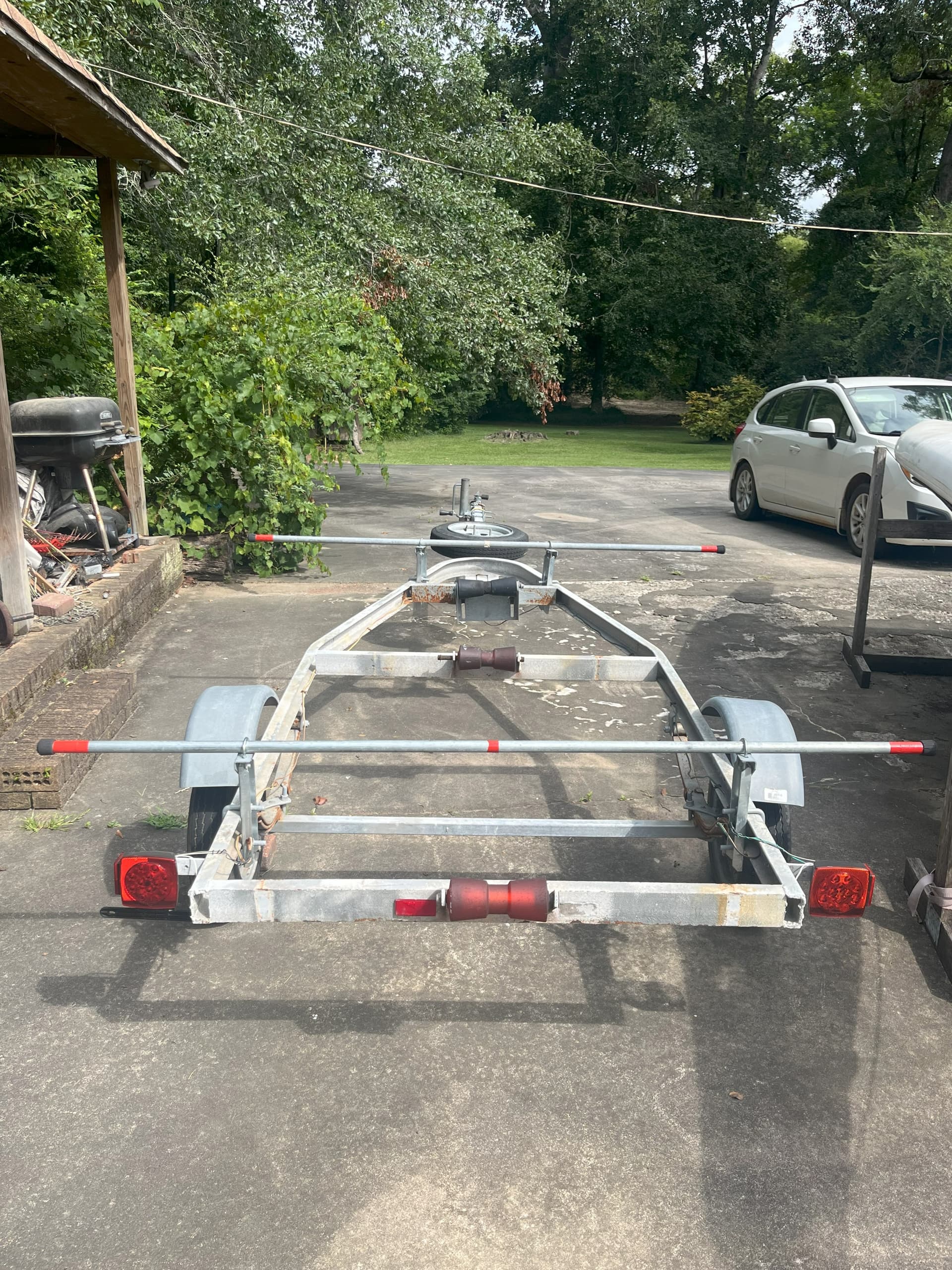

I picked up a used small boat trailer for $400 and removed most of the original hardware and put cross bars on it. I find it very easy to load.
