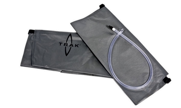

Trak makes a set of two very large float bags that can also be used as gear dry bags which you can inflate after filling with cargo. A bit pricey at $130 but would be very useful if you plan to take longer trips and pack for camping.
Thanks for all that info. Very useful. The Trak bags look like a great option although they are HUGE!. They have smaller bags but they’re even more expensive. Gotta love those Trak kayaks though. Drool. I would like to get clarification on something. Trak and other skin-on-frame kayaks have no inflatable sponsons. In this case, the flotation bags would be absolutely essential. But the Quest 150 has inflatable sponsons running the entire length of the kayak. Wouldn’t these serve the same purpose as float bags on each end? Wouldn’t bow/stern float bags be redundant? Are the Quest’s sponsons not enough to keep the kayak afloat and assist in water removal?
