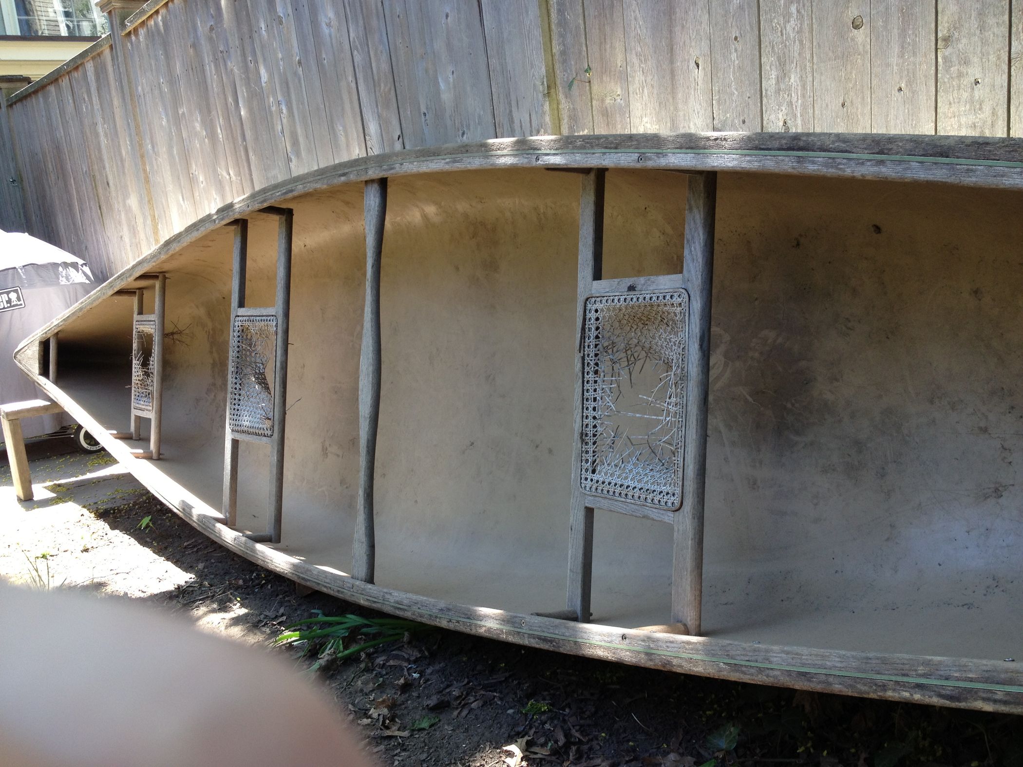

Rotted outer gunwale old Mad River Outrage
I left my old Mad River Outrage behind the toolshed all year when we moved. The serial number is MAD14327K900, so I’m guessing some time around 2000 or 2001. The outer gunwale on one side is both rotted and cracked thru in 2 spots. When I removed it I also noticed a big crack in the hull under the gunwale.
The inner gunwale looks and feels ok, I redid all the pads and straps a few years ago.
The wood seems to be 13/16” rounded trim (possibly 7/8” to the rounded edge.
I’ve never bent wood:
  1. can I replace this gunwale myself? Are gunwales like this available somewhere preshaped?
  2. how should I repair this 5” thru and thru crack in the hull?
    Thanks guys, I really want to get back in my old boat again

the crack is easily repaired, get some fiberglass or kevlar and some G-Flex epoxy.
Cracks are shearing situations and will continue to grow if not “capped”. Melting makes a more stress-free cap than drilling so cap each crack in the hull ABS by pushing a heated 1/8” drill, shank endfirst, through the ABS at the crack’s end. Meltonly to the foam core. It’s really easy to melt all the way through the inner sheet of the ABS too so you must take care not to.
After doing that, wash the hull around the crack with soap and water, let dry, clean with alcohol. Tape around the repair area. Apply G-flex then fiberglass, wet the fiberglass fully. I usually do a fiberglass patch both inside and outside for the longer cracks like that.
Use saran wrap or similar to cover the patch while curing, this helps to get a smoother finish. Watch for drips for the first few hours of curing the epoxy, wipe up.
I’ve used kevlar to repair a much-cracked Royalex hull on a ME Explorer. At that point it seemed the consensus was kevlar with G-flex epoxy, single patch. Others like 3 layers of 6oz fiberglass instead. To me it seems that would build up quite a lot of epoxy over the patch, so I went with Kevlar Aramid cloth 5oz. On the long cracks I did a patch outside and inside, on the smaller ones just on the inside and made sure to fill the crack with epoxy.
So far that’s held up five years and counting, bouncing down rapids, long portages in Boundary Waters, etc.

read that article before - but all that careful sawing cutting and gouging is not in my wheelhouse - the fiberglass/kevlar patches just go on top of the crack, a bit uglier but stronger and much lower-tech with lower risk of doing further damage to the hull.
