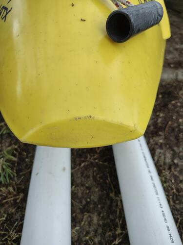

I’m struggling to come up with an idea on how to attach a mount to the rear for the store bought drop in variety. I was thinking of a piece of C channel but the rear of the kayak has only a small area about 30mm high and its sloped inwards and curved - see photo. Seems like it would be challenging to get 10mm holes aligned vertically off this.
The Fish and Dive had a small cult following in California several years ago among kayak fishermen. Unfortunately a few of guys I have known that owned them have made the passage to the great Catalina Island in the sky. I have never seen a motor mounted on one. I think the hull is similar to the hull of a tandem they sold many years ago, that I paddled quite a bit in Baja. I don’t think the hull will work with a motor, but I don’t do motors on kayaks. Why not stick to a good paddle?
