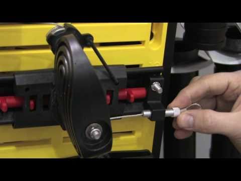

I prefer skeg boats; nevertheless I have an (extra) Tahe Seaspirit kayak with an older Smarttrack rudder system. This gives good foot purchase without moving the rudder. Once adjusted to your leg length, the footpegs remain fixed. The top of the footpeg is hinged and works like an accelerator pedal to move the rudder. This works as desired with any of the usual footwear choices.
The rudder is spring loaded and stays fully down when deployed, not drifting upward like many sliding footpeg designs. But if the rudder hits an underwater obstacle it can ride up and then returns to fully down when the obstacle is gone.
When the rudder is not deployed, it stands vertically up. Some people don’t like this so it may have been modified in later Smarttrack systems?
Just like a gas pedal.
Works with paddling shoes or boots fine. Cables not on your legs.

The SmartTrack and Sea-Lect rudder controls both work the same way. A fixed adjustable foot peg that acts like a gas pedal to control the rudder. The difference I have found between the two is the way the cable is routed at the pedal. The SmartTrack seems to stress the cable, causing it to fray and break much sooner than the Sea-Lect pedals.
The rudder in both is deployed by a line and cleat on the rear deck. The control cables are routed up high and right along the sides of the cockpit. You generally won’t even know they are there. On some boats they are partially sheathed in plastic tubing.
The sliding foot peg design is pretty much obsolete. It can be replaced fairly easily with the newer style foot pegs. The only time the sliding style foot pegs are fixed is when the rudder is not deployed and parked in a bracket on the rear deck.
