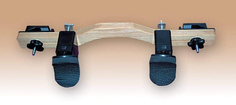

Here you go

@kayamedic
I’m not sure I’m strong enough to hoist the kayak over my head to use something like this.
Is there a trick to getting it on your shoulders? I kinda struggle to do an overhead press with the boat to put it in the J-Hooks on my outback. Some of it is due to being old, some of it is due to just the unwieldiness of the thing.
To that point I stopped using the Subaru J-Hooks and opted for the Malone ones, with the Kayak loader ramps.
Since my boat has a rudder, Flipping it upside down on the ground might be a bad thing. I assume you have one of these so any hints would be helpful.
Support one end. Nothing says the bow has to go first. I have a Monarch and it can be done letting the bow rest on the ground and “rangering” backing into position into the yoke. Rudders don’t like to be ground into the ground for sure.
Google canoe portaging… you can balance it on your legs and then use your back to get it overhead
Like this . I have not done it with a kayak. In portage country I vastly prefer my sub 40 lb canoes over my 56 lb Monarch! But take a look anyway
