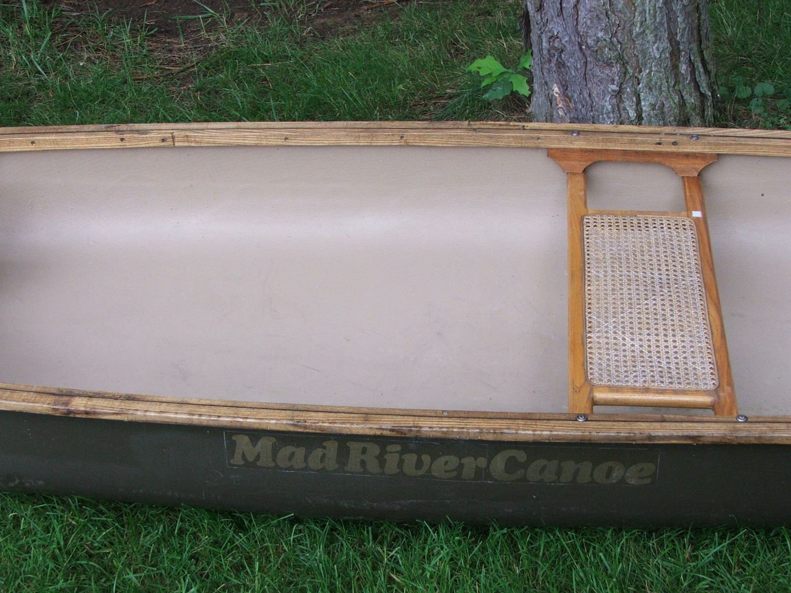

not sure about posting a photo - hopefully this will work.
at least getting new seats and replacing the middle seat with the original thwart.
when i did the gunwales i did not follow the 10:1 or 12:1 rule for the scarf joints. - inwale joints visible in this photo - will post another angle view of the bottom for more color - the color is an olive brown to my eye
sorry - this will not let me post another photo but if you search the net for mad river duck hunter you will see the color better.
I have used short scarfs for canoe gunwales (1:3) and they work just fine and are no more noticeable than long scarfs. When joining thin panels together, like 3 or 4 mm thick Okoume plywood, long scarfs are necessary to achieve enough bonding surface for your adhesive or epoxy. With canoe gunwales 3/4" thick, they are not.
