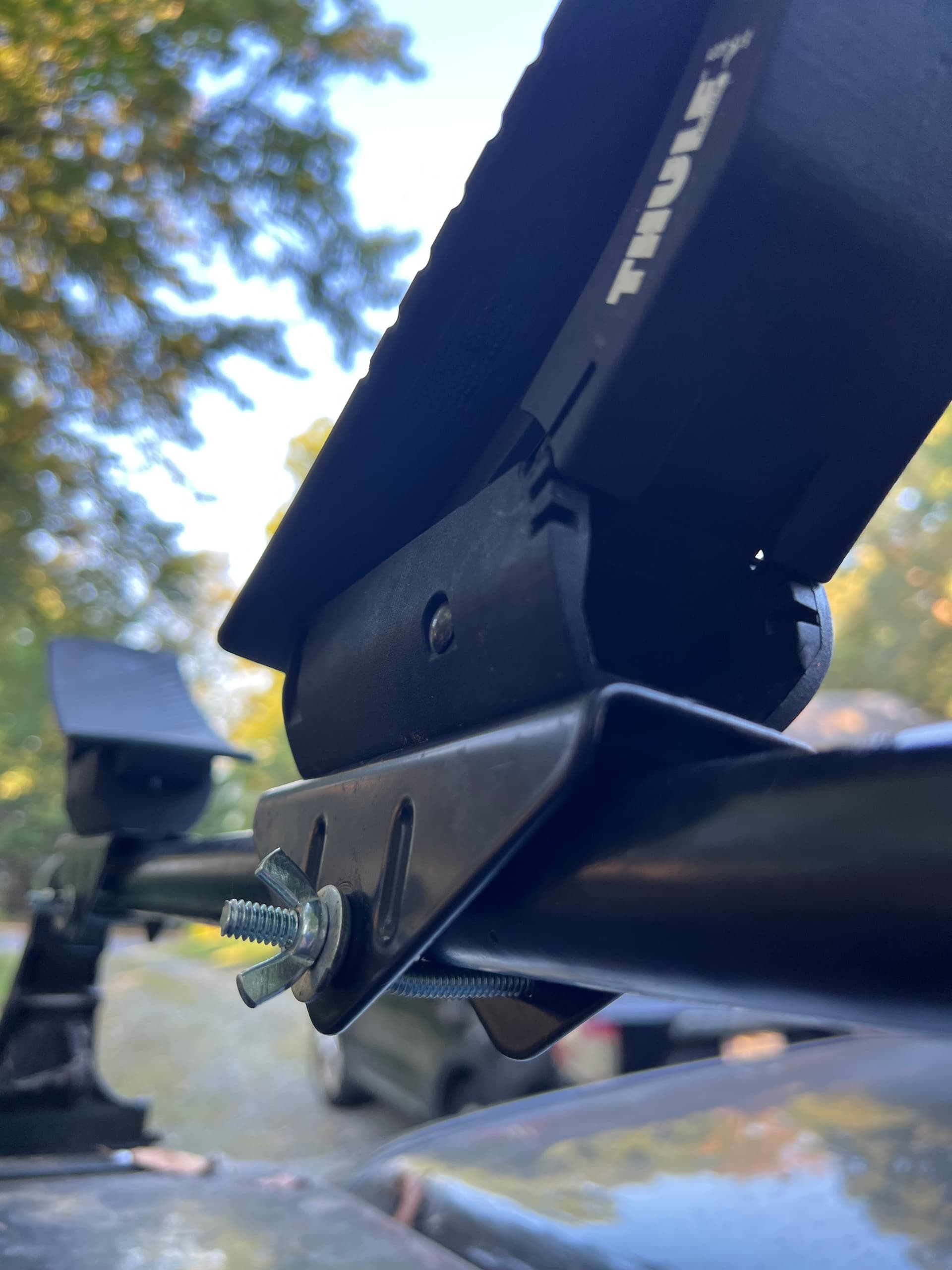

For the Thule kayak saddle h2go #876, I replaced the original carriage bolts with 1/4" bolts that were thin enough to bend around the larger Yakima bar, yet strong enough to keep the saddle in place (kayak is secured not to the saddle but to the bars and to the car).
