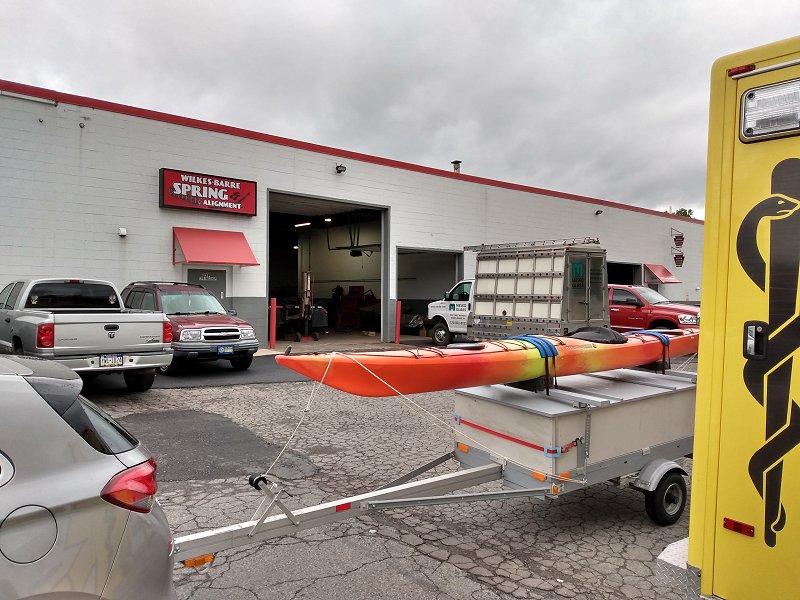

This happened to me on a dirt road 10 miles from the highway on the Rio Chama. Ended up having to drive almost to Albuquerque to find a Tractor Supply that had the replacement spring, then go back and fix it in camp. Good thing everyone in my group is good with tools. We got it changed in a little over an hour (after the 4 hour drive to find the parts). Lesson learned. I always carry a spare as well as an extra set of wheel bearings and tools when I am going to be far from home. Some days a spare tire just ain’t enough.
that’s a cutie… Can you load boats on it?
Yep. The Thule 450 or 450R feet mount on the top side rails and you can then use a standard Thule bar and kayak mount. With the longer version of the tongue (installed on my trailer) there’s clearance for a couple of 17-18’ kayaks. The trailer weights 300 pounds and can carry another 500. The suspension is designed for this weight, so there’s no bouncing or abuse of the boats or bikes on top…
