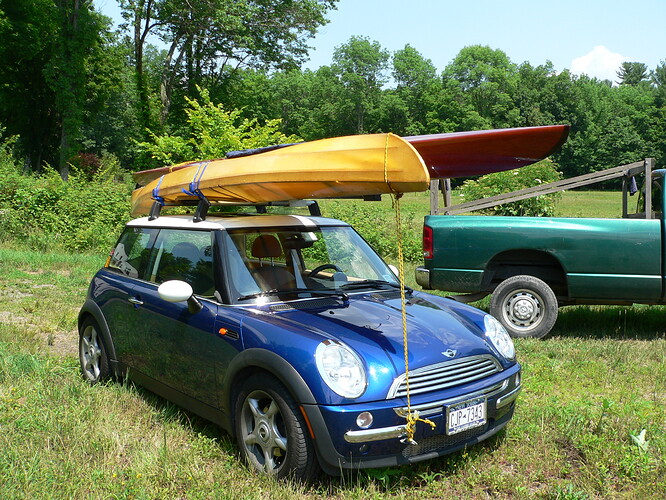

Well, it took a while but found the photos I was looking for. When I only had one V-bar carrier on the roof, I would occasionally carry a second boat directly on the crossbars. This worked fine, but I eventually went to using two V-bars.
I didn’t use foam on the crossbars, since the skin boat shown has a fairly sticky surface (nylon fabric with a flexy coating), and the other rack prevented lateral motion.
It’s on the passenger side so the bow will be over the tow hook for the bow tie down. Note the line goes through the forward grab loop and is wrapped around the hull - that puts the load on the hull and prevents over-stressing the grab loop.

@carldelo I love your mini!! I was wondering what my tiny car would look like with a boat on it, you definitely answered that question. My other car is a Miata, and that definitely wasn’t happening with a kayak so it’s good to see that this will work out :).
