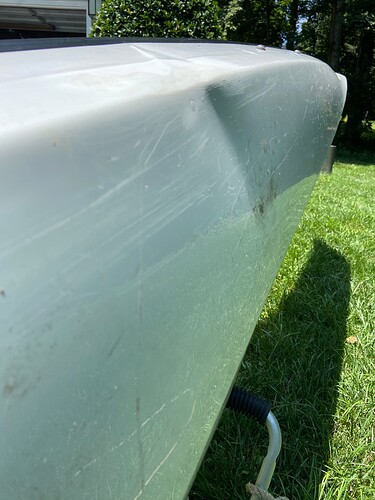

Picture of dent?
Here’s a photo showing a dent.
I’m taking the boat out Thursday (7/13) and will try to get other pictures showing the dents.

More than what I would call a dent the material is fractured. It needs repaired with more than heat.
I would remove the dent first then do an epoxy/glass repair.

I must say the dents are not as severe as I recall them being when I worked on the boat last winter. Could some of the dents come out while the boat was just sitting in the coolish workshop? Then, I laid the boat on the driveway last week on a 90-degree day. The pavement measured 130F. After a few hours, it didn’t seem anymore malleable than normal.
I included a photo showing the worst dent. The sunlight and camera angle accentuate the dent so that it looks worse than it is. Pretty much the same as photo already posted.
