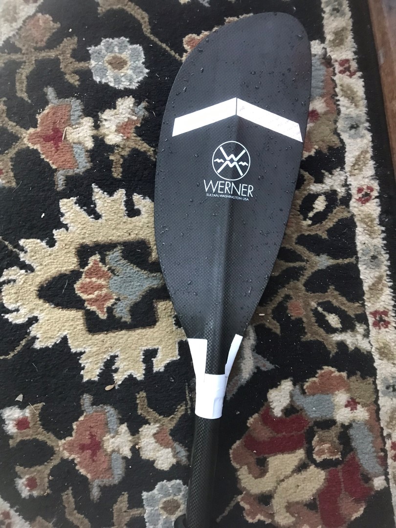

If you did some research and found that others have had the same issue it sure sounds like a marginal/poor design (unless you feel that you have been abusing the paddle). I have never heard of water penetrating a carbon canoe paddle and I’ve used many (including a 6 ounce ultra light) on shallow rivers with constant hard rock hits; carbon canoe paddles typically have at least half an inch of solid carbon fiber at the edges before you can get to a hollow or foam filled fore. Unless you used it as a shovel and also to chop down trees I’d expect the manufacturer of such an expensive premium paddle to stand behind their product regardless of the warranty period.
Thanks, Marshall. Will cross that bridge when I come to it. Alas, my pseudo-MacGyver attempt didn’t go well today. The electrical tape I used was vinyl and started to peel off about 20 minutes.
Tomorrow it shall be helicopter tape!
@TomL The other cases I read about had water in the shaft which was caused by a leak in the plug. One guy drilled a hole in the plug to release the water (unlike mine which drips from the blade edge) then resealed the entire plug.
No shoveling, chopping, rock gardening or playing lawn darts with it. Paddle is transported in a Seals padded bag I bought from The River Connection, rinsed at home after each use and stored on the wall, blades up.
My hands were dry today as was the shaft, except where it meets the joint and is submerged during the catch. So far about a teaspoon of water has dripped out from a specific area on that blade edge. As that’s the only place the water comes out, then I figure that’s got to be where it enters.
If I do have to send it to Werner and they don’t cover it under warranty, I’m not sure I’ll want to pay $228 to fix it since that’s more than half the cost of a new paddle. Guess that will depend on what they find.

Just FYI I’ve never had any issue with electrical tape sticking to any of my canoe paddles so don’t give up on the theory that your paddle may be haunted.
You must have better tape than I do. Put on white heavy duty Gorilla tape, which makes the paddle look like it visited the E.R.

The leak is in the joint or along the edge of the paddle. The Gorilla tape, shown in the photos, kept water from entering. Plan to drop Werner an email, including the photos, to let them know.
I have a bottle of Captain Tolley’s so will try that first unless someone has a better suggestion.
White stuff along edge of paddle is frozen snow as we had six inches overnight.
If it’s in that joint it may be structural and you just can’t see the flaw. Carry that spare…
Ooh. Agree with Grayhawk, that is not a great place to have a problem. It is a stress point in the flex of the paddle. It might just be a flaw that took some use to open up. But it could be a point of sudden failure.
Not going to be surprised if Werner offers to replace it, unless you tell them you have been out bashing the paddle on rocks for the heck of it.
