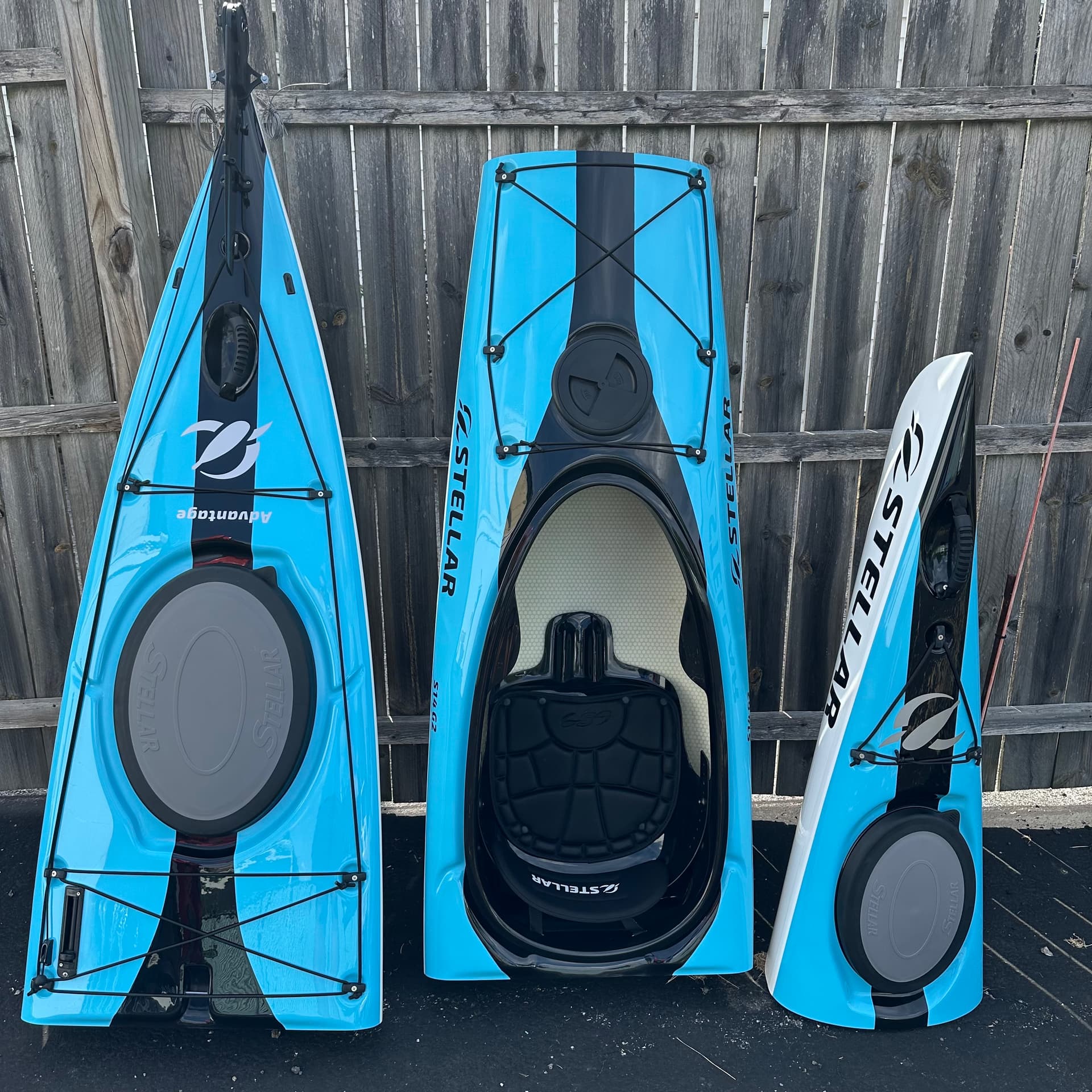

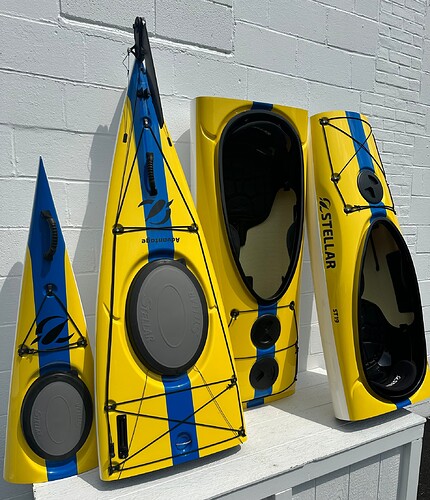

Stellar Kayaks already does this and is expanding the models that can be sectional. The ST14/19MOD allows for one or two cockpits and the S14MOD is the same as their most popular model. For longer sea kayaks the S18EXP & Egret have that option. Oh, and at their heaviest you’re at 45lbs. For an 18’ single or 68lbs for a 19’ tandem

That’s what I’m talkin’ 'bout! As usual, Marshall’s got the scoop. Let’s hope it takes off and the secondary market makes it reachable for the waitress.

I have them in stock so if you want to procrastinate work, more pics here;
