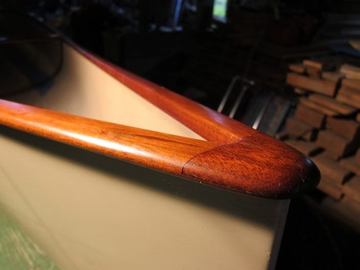

Watco yes - Deks Olje yes yes
– Last Updated: Nov-06-12 2:31 PM EST –
I've used Watco Teak (Marine) for years and like it a lot, but I've had better results with Deks Olje. In 1985 I applied 4 or 5 coats of step 1, then 2 coats of step 2 to the rails on my Proem 85. I've never needed to do any other maintenance and have used this boat extensively. The wood looks about the same as it did in 1985.
Here are pictures taken of that canoe within the past year.
http://i1237.photobucket.com/albums/ff470/mvbrando/Proem%20Rails/IMG_6996.jpg
http://i1237.photobucket.com/albums/ff470/mvbrando/Proem%20Rails/IMG_7001.jpg
http://i1237.photobucket.com/albums/ff470/mvbrando/Proem%20Rails/IMG_7000.jpg
http://i1237.photobucket.com/albums/ff470/mvbrando/Proem%20Rails/IMG_6999.jpg
http://i1237.photobucket.com/albums/ff470/mvbrando/Proem%20Rails/IMG_6998.jpg
http://i1237.photobucket.com/albums/ff470/mvbrando/Proem%20Rails/IMG_7002.jpg
-mike

My compliments. I’ve been using Watco on my Explorer’s ash gunwales, and while I like the way it makes them look I might have to pony up for some of that if it will get me those kinds of results. Much longer lasting too.

As to Mike’s Proem – reportedly stored between uses in the Smithsonian preservation vault – I would ask what kind of wood that is. Red oak?
