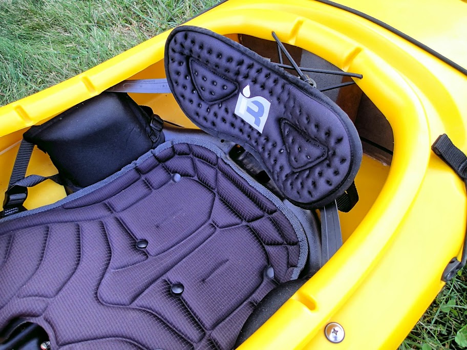

I have an IR backband in my Tsunami 140, could send you a couple pics if you want of how it’s mounted. I think the only drilling I did was two small holes for the suspension bungee on the rear lip of the coaming.

here you go
I attached the ratcheting straps using the rear of the two seat-tower screws on each side, I think that’s kinda what Mr. Marshall described above. The other way is to dremel a vertical slot at the back of each seat tower, the IR backband kit comes with these cylindrical anchors that you could put in there and run the straps through the slots. The lazy way worked good enough for me. Once you remove the stock backrest per the Wilderness video instruction, this is a 5-minute install.

Thanks, that’s exactly what I wanted to see. Looks gorgeous. I’m doing this.
