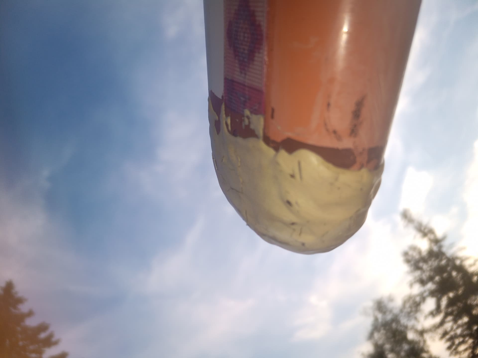

Looking for advice on how to repair kayak bow with cracks
This is an old Boreal Design fiberglass kayak, with an old repair that is now cracked and coming apart. What I am considering is sanding away old white gunk and the gel coat in the near area. Then filling the crack with Fiberglass particles and resin. Then covering the whole front end in several layers of fiberglass and resin to strengthen and repair the damaged nose. Then add two eyes and a smiling mouth. OK maybe not the last one. Would you do something different? Any one repaired something like this before and have some advice. Thanks.
Sounds like a good plan. What in Poseidon’s name did they put on there?
I would grind/sand off;( 2" back feathered), sand smoothish, fill in with fiberglass two or three alternating layers. Epoxy layers and fill in weave. Clean with denatured alcohol each layer. Sant to at least 220. Then paint. I don’t do gel coat . (Makes my breathing parts unhappy.)
Generally epoxy sticks to polyester, but not other way.
Or perhaps sand out, carve a big wood ball, or perhaps head and epoxy that on, paint face🥴… or not.
First picture kind of looks like the diseased nose of some kind of animal, maybe horse, camel, moose.
Thanks, that’s basically what I intend to do. Fill the cracks with an epoxy fiberglass mess mix, and then once that is dried, layer over with epoxy, fiberglass cloth until well built up. Once dried solid and sanded will decide if any further finishing is required. Paint, or gelcoat. If I am doing a gel coat though the whole bottom would benefit and not sure I want to do that right now.
Cut away and sand off all of that ugly mess. Use foam to restore the contours of our boat by adding and sanding. Then add several layers of fiberglass and marine epoxy and paint it.

I would sand and feather it back inside and out. Then make a type of Bondo with West Systems epoxy mixed with adhesive filet they sell. You can make it any consistency you like. Pack it in and shape it back so it looks normal. Possibly put some expanding foam to close the hole up on the inside or wax paper ball as you said.
Possibly cut some glass and push in from the inside with a stick or pole covered in wax paper on the end. Then reshape it on the outside.
I had a similar problem on a great old Sawyer Charger. Use spray foam in a can and fill the whole void to seal it up. Then use a sharp utility to get the rough contours and sand it to restore the shape of the stem. Then fiberglass cloth and epoxy in multiple layers.
Could you mill a block of wood to the approximate shape that you want but slightly smaller, cover it with wax, and then push it into the bow from the inside. The top of the nose should stop it approximately where you would want it. It might be even easier to shape a piece of rigid closed cell foam with the thought of leaving it in place afterwards. Then use it as a form to install new glass and epoxy, Marine-Tex, or similar material, building it up to the correct shape. Finish with gelcoat.

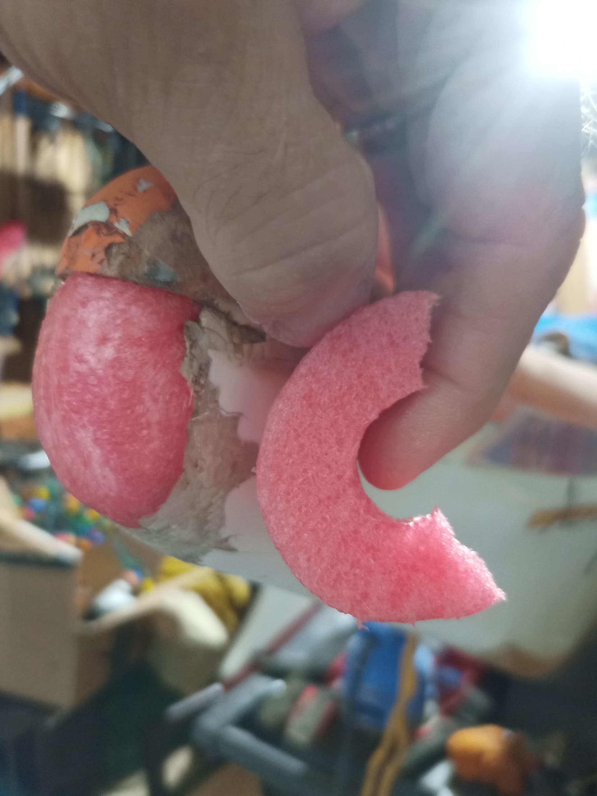

I Pondered balls that can squeeze into shape, food materials- bread, carrot, potato (that would melt away and disappear after), then I thought of foam noodles and cutting a chunk of that to shape. This would add some buoyancy to the tip of the kayak, and only a little weight.
I’m thinking I will try the foam noodle first and if that does not work perhaps some kind of spray foam as ppine suggested.

It is just some white epoxy based surface restore material I believe. When I first tried to protect a keel on a fiberglass canoe I used something like that. It lasted for about 2 seasons and then was cracking and chipping off with all the ground scrape contact. I then did a proper fiberglass keel guard. This feels like that type of material, and I am going to do what I hope will be a proper fiberglass repair.

Here is what it looks like using a small pool noddle cut in have and squeezed into the end. I think it looks pretty good. Nicely shapes to the nose of the boat.
Now to do some final clean up of the surface around the hole.

Another thought. Should I prime the foam surface with something like a wax to prevent a solid integration with the fiberglass/epoxy layers? This in theory would allow me to remove the foam after the glass layers dry and harden. Then I could poor/drizzle/paint some epoxy resin down on the inside end of the nose. What do you think? Is it worth trying to allow for more resin on the inside after the outside is done? Feels like the nose will end up being bullet proof and the strongest part of the boat. Could turn it into a ramming end like a Viking boat. Of course if I do that I will definitely need to put some eyes and a mouth on the end. A mouth with teeth perhaps. :smiley:
Sorry, my idea of doing an end pour to create a solid end was only provided in a “brainstorming” context, as I have no experience with doing this type of work. Upon re-reading what I wrote, I make it sound like I know a lot about this type of work when I actually do not. But given your situation, and given that many kayaks do have an end that is solid, and filled with epoxy, it seemed to be a possible approach to consider.
Your foam looks well shaped and fitted. At this point you may want to ignore my suggestion.
What could serve to allow you to remove the foam after the epoxy/fiberglass layer is cured will depend upon what you are using. I have wrapped things with plumbers Teflon tape, for very different projects, and that has worked.
West System Epoxy does not stick to some plastics, indeed they sell plastic stirring dishes and stirring paddles, and the epoxy just pops off after curing. But how well either idea would work, I do not know. If you try it, don’t forget to attach something to the foam to allow you to pull it out later, and even that might not work due to the fragile nature of the foam.
The other way to do this potentially, again from someone without experience doing this, would be to roughly shape something to contain the epoxy pour, leaving the end hollow. Something like the small dishes used to mix the epoxy. You will probably have to fabricate something. Then do the pour. Then shape the protruding epoxy, as you have done with the foam. Then do the fiberglass work over that.
