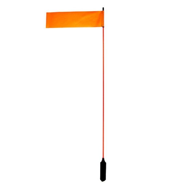

Need a flag that fits in a fishing rod holder? Here you go:
YakAttack® VISIFlag™, GearTrac™ Ready - Kayak Fishing Essentials
