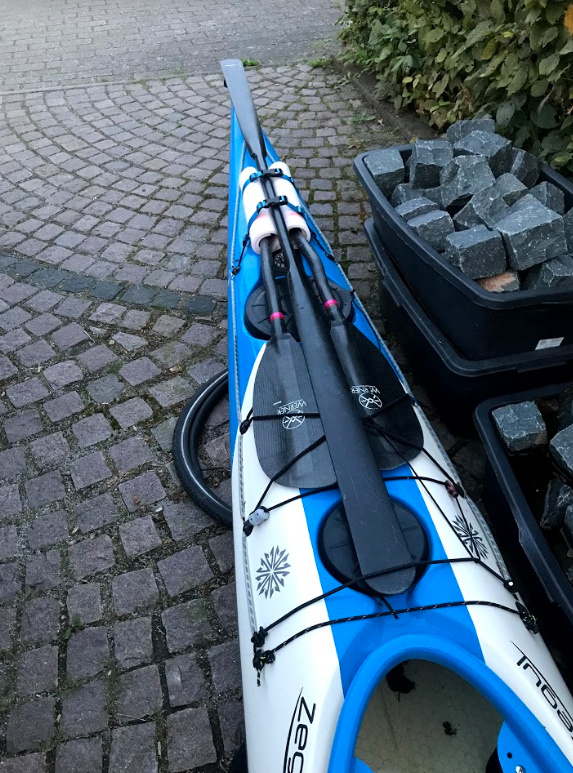

Stowing a full length GP is certainly not easy. A lot of people stow it under one of the deck lines near the bow, but that will bring it in a position where it easily catches a wave.
On one of my kayaks, I have made a DIY stowing solution for my euro. It has turned out that it actually works quite well for a full length GP in a way, which was never planned.
I wanted access to my front hatch without having to remove my euro, so I came up with a design with two straps, which I could release and just pull the paddle shafts to either side when accessing the hatch. It turned out that these straps are also near perfect for the GP.
If you have a split GP, I will recommend the yellow pants from North Water. Make sure to get the model with buckles between the two halves, so you can separate the ends as in my photos. I have those on two other kayaks, and they are very sturdy.
