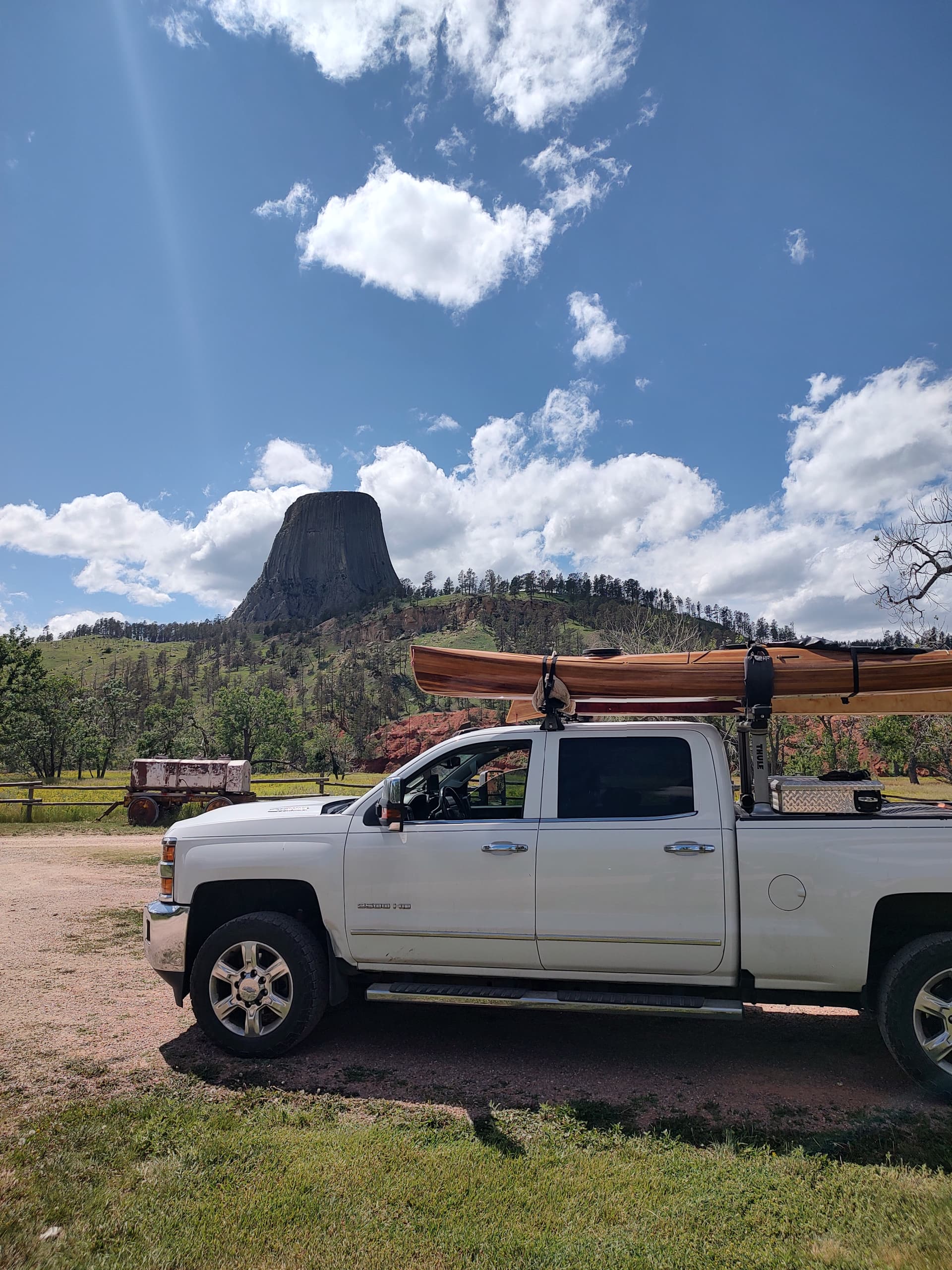

The OP complained about all the mass of Hullavator left above when boat off. All that comes off by opening the cradle (squeeze release) to vertical and removing that pin underneath. There’s also a lock where you lock the cradle down. I’d take boats off and show but it’s 90s and getting hotter. I’m trying to post picture.

Hello Bakerman. What design is your woodstrip kayak? I built an Outer Island and am curious about yours. I assume you carry your kayak upside down because perhaps the Hullavator doesn’t cradle it softly enough when rightside up. I’m looking into lift-assist racks for my wooden boats and welcome any input (Hullavator, Showdown, Tooenjoy). Thanks!
The stripper in the pictures above is a Petrel Play designed by Nick Schade of Guillemot Kayaks. It was built from plans. It is carried upside down because the hatches leaked when first fitted.
The one you see on this pict is a Petrel Sport, 16ft version of the Petrel Play. It has normal rubber hatches that do not leak. It is carried right side up cause the hatches conflict with the cradles when upside down. You will note that we carry the boats on three racks to get them forward to provide clearance ahead of the travel trailer.
This the Hulivators can be adjusted to carry one up and one down.
Soft enough …yes I contact cemented foam onto the bottom of the Hulivator cradles. Same foam as used for padding on hip, knee pads and seats. The Yakima cradles are covered by some padding my wife made in the design of a shower cap. They protect the varnish.
