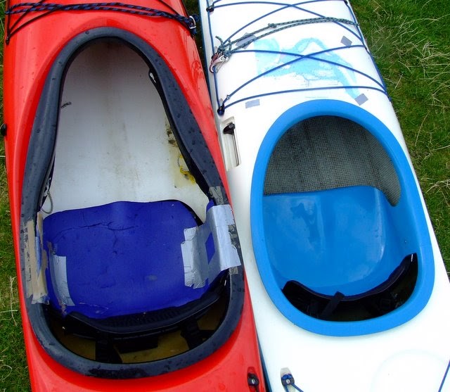

Discussion and comparison of “keyhole” vs. “ocean” cockpit:
This is a past effort of mine to make a foam “masik” which would effectively reduced the size of my “keyhole” cockpit to an “ocean” cockpit. I personally find an ocean cockpit more conducive to edging and rolling (particularly to the variations of Greenland rolls) and thus, for me, more “safe” for rougher water paddling.
